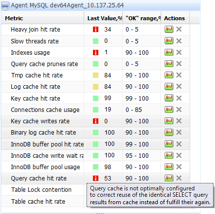

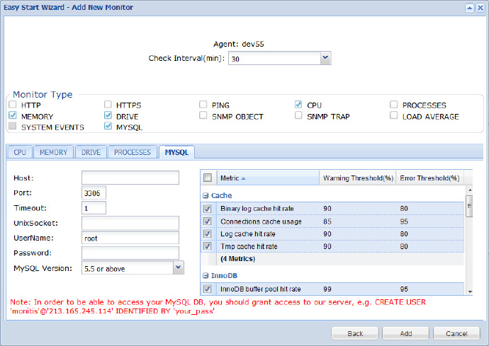

最后 101: 执行MySQL 监控: Monitis Unveils The World’s First Free On-demand MySQL Monitoring.
Add MySQL Monitor
